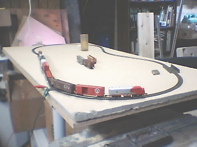

I threw this little bitty together to try out the N scale stuff I got. The decision, N scale is just too tiny for me. But I had a little fun ressurrectiong some N scale from a certain demise. Someone else may get more fun out of it. Cars are really too light and need weighting. I'll see if I can find a motor for the one engine with the hald dead windings. If the hobbyshop still has some stuff hanging around I'll nab it to restore it the best I can. Then give it away as a gift or something.

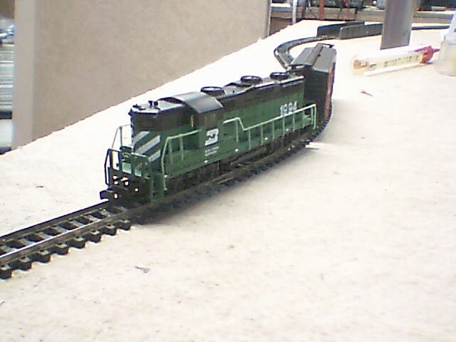

I picked up another N scale bag-o-goodies, this one had a few cars then also this LifeLike Geep I dropped it on the track to test it, it was rather bad. Found wheels dirty with crud, I scraped that off (I took the engine apart, that was an adventure by itself) After that tried it again, it ran much better, BUT, it just would not stay on the track, derailing. I wiggled the trucks around, it felt like something was inhibiting its turning with some little "blink" of " I cahnt taern it any more capn, or she'll blow" Both trucks had this "blink".You could turn the trucks but you could feel this "blink" I couldnt see any obvious obstructions doing this, the copper blade pickups? noooooo BTW, it has all wheel pickup. The frame had indentations for the wheels to pass thru so it wouldnt..."blink"...whut now? Looking harder (I had closeup glasses) the trucks have a detail that rises up slightly. Thar she blows. Popping the "rivet" that holds the truck down, I filed up the frame areas where the detail was rubbing on. Put it all back together and put couplers on it. Lubed it up. Sweet running little geep now. No wonder the previous owner gave up on it. I wonder how many other LL N geeps are like this. Pretty good looking one for N scale. 15 bucks for engine and a few cars. Nice deal...
