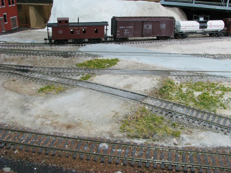

Need some help with a road- UPDATED 2/29
I'm trying to create a gravel road (in a southwestern setting) and I can't seem to get it right.  I'm using sand sifted through a tea strainer to ge the approximate size but it just doesn't look right.  I've tried different colors and highlighting the well traveled parts of the road but it still doesn't look right.
Here's what I'm trying to do.
Any information, guidance, suggestions, or criticism will be greatly appreciated.

It appears to me that there is not enough variation between your road color and your ground color. I would try sprying the road with a little india ink in alcohol to darken it a little.  I would also put some ruts in it as a starting point.  i would also clearly delineate the edge of the road with some vegetation (even dried) or a sign or two.

Charlie, your road looks fantastic but not for the southwest.  Back in 2003 my wife and I took a trip through New Mexico, taking over 600 pictures.  Oc course, I only found one pic of a gravel road.
NDBPRR, your idea about delineating the road with vegetation is good but as you can see, there is little if any color variation between the road and the surrounding terrain.  Although it doesn't show in the picture, the road itself is built up to the top of the rail.  The coarser rock along the edges was an attempt to separate the road surface from the surrounding area.  Here's a picture showing this from a different angle.
Again, good suggestions everyone.  I will keep wroking on this.

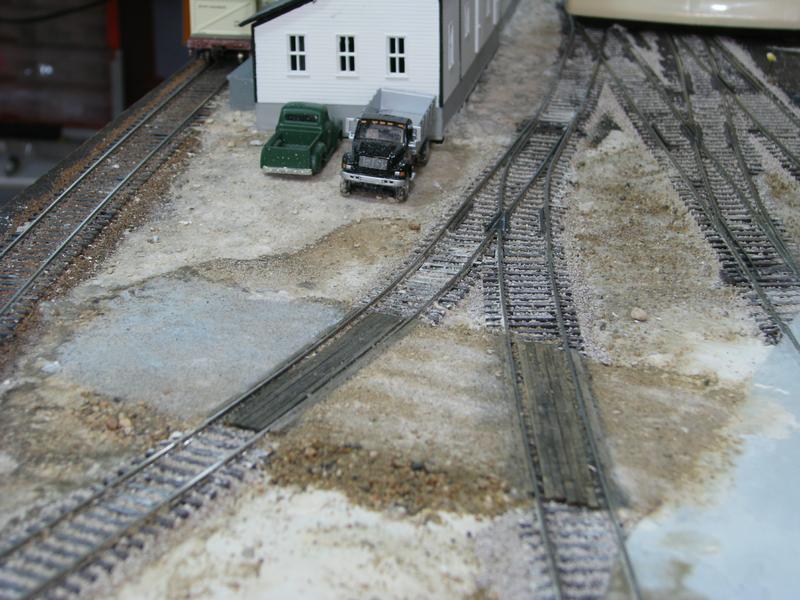

 Charlie, that's a good lookin' pile of junk and barrells in the background.  Are they styrene or cast metal or what?

I dunno Tom, that last shot looks pretty darned good.  Seems all you would need is some bushes etc off to the side.

I'd guess that a gravel road would have perhaps 3/4 minus gravel on it? In HO scale that works out to pieces of gravel about .009" and smaller. How big is the gravel you were using on your road? WS fine ballast is just too big.
You last picture did show signs of starting to look fairly decent, but the road wasn't really up front and personal so its hard to tell.
Would there really have been fully timbered grade crossings there? Or just a pair of timbers next to each rail?
How wll are those roads maintained? Unless they had a grader out there all the time I'd expect they might get a bit wavy and lumpy. I found that using dry wall spackle for the final contour surface of the roads worked pretty well. After it dried I'd rub on it with a wet sponge until the rough edges smoothed out.
Perhaps the idea of Arizona rock and miniral granite dust wasn't such a bad one?
And perhaps it will all start to look better on the layout when you have scenery next to the roads in place?
Keep posting to show us what you discover!

The 'junk' was a combination of WS cast metal details, chooch cast resin stuff, grandt line 50 gal drums, preiser (I think) pallets, and other odds and ends I had left over from building other stuff. Oh and some distressed discarded ties.

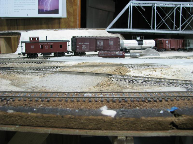

Been trying a few things.  Please advise on my rogress.

That looks better. (better color) What did you do?
Maybe smooth it out a little more.

I went with a little darker color and while the surface was still damp, I dragged a small wire brush across the surface very lightly.  Then as it dried some more, I used my fingertip to soften the grooves created by the wire brush.
