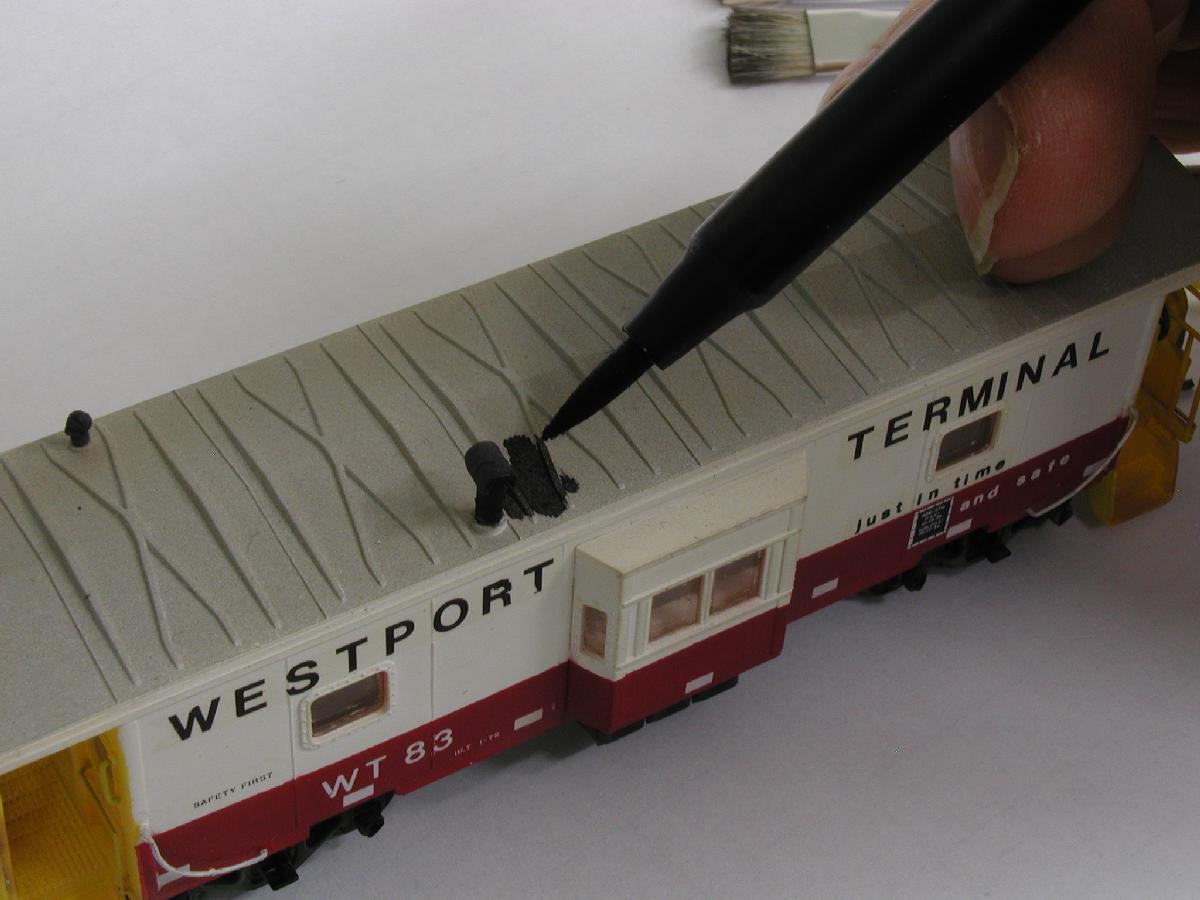

I've started - following my friend Pete's suggestion - weathering with felt tip pen:
Wolfgang

Here's my latest car I did for Ebay, and it's done by hand.  I only airbrush the dullcote. As far as felt tip pen's, I would be worried that if you mess up, How would you fix it?
